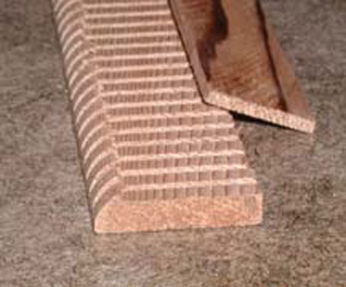

Hey guys, I've had several requests for the linings that I make. These are CFox style capped linings. They add a level of rigitity and stiffness to your sides without having to have the box closed up to do so. In my opinion they are far superior to any other design.
So I'm rebuilding my setup to make these and thought I'd put the offer out there to see if anyone wants them. They will be more expensive than any traditional linings but they are much different. I've charged $32 per guitar (4 kerfed linings and 4 cap strips) in the past and think that will be the price I'll stick with.

Ok, here they are. I think they sort of explain themselves but if you need more explaination, let me know.

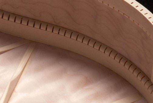

Todd, you hit the nail on the head. You are gluing a flat surface to a flat surface so you don't have all that slop oozing out. then the cap strip gets glued on to the kerf and any ooz is down inside, far out of any sight line.
A coulple of advantages of these vs. the reversed linings I've seen. 1) the cap is thicker than the solid part of the reversed lining so the rigitity is even greater. 2) they won't break as easy. The cap strip is .070 which is easily bent in the Fox bender. The kerfed piece is .25 at its thickest part which is then kerfed so it's also very easily bent. I've only broken one piece in my career and that was just a couple of weeks ago on the cutaway of an archtop. The kerfed part broke on me so I just butted it back and when the cap was on, I couldn't even find the break.
